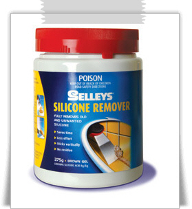

ژل مخصوص داره ، باید ژل حدود 2 الی 4 ساعت روی سیلیکون باشه بعد راحت چسب ها برداشته میشه :
Selleys Silicone Remover
Features
Save time as it works in 2-4 hours
Less effort as it breaks down the silicone for easy
removal
Easy to use, as the gel consistency makes it ideal for vertical surfaces
No residue – leaves a residue free surface that can be painted
Available Sizes
375g Tub
Colours
Brown
Appearance
Gel
How to use this product
Ensure surface is completely dry, as water contamination will render the product ineffective. For fast results firsly remove as much of the old silicone as possible.
Read the safety directions before using the product. To open squeeze the cap as indicated while unscrewing. Use a scraper to spread a 5 mm thick layer of silicone remover evenly over the old silicone.
For effective removal leave for at least 2 hours. For thick deposits leave for 24 hours. In some cases a second application may be needed.
Use a scraper such as the 50mm ROTA COTA Soft Grip Scraper to remove the softened silicone from the surface.
Clean surfaces and tools immediately with a cloth soaked in methylated spirits.
An oily residue will be left on the surface which can be cleaned with a rag soaked in Methylated Spirits.
If Silicone Remover is allowed to dry on the surface a white powdery residue will be left. This is harmless and is best cleaned with a wet rag.
If you are applying new silicone refer to SELLEYS Silicone Sealants.
با تشکر از شما دوست گرامی! از کجا میشه تهیه کرد؟ آیا در ایران پیدا میشه؟

در مورد نظر استاد شاطی زاده
برای پیدا کردن این ماده به نظرم به یه چسب فروشی
مطرح شهرتون مراجعه کنید
بگید حلال چسب سلیکون میخوام
