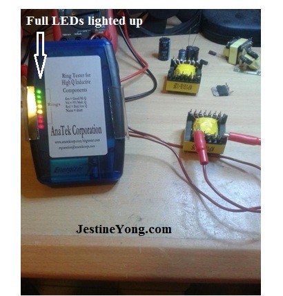

I suspected the main filter capacitor but after replacement the problem was still the same. My next moved was to check on the SMPS transformer primary winding. The Blue Ring Tester showed full LEDs and this means the SMPS transformer primary winding was good. When I checked on the secondary winding I found that it was open circuited causing the bulb to light up.​
Here is how I have checked the transformer:

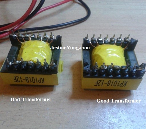

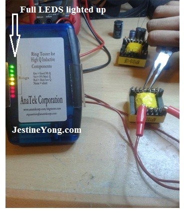

I removed the bad Switch Mode Power Transformer (SMPT) and compared with a good one. I checked it the way as mentioned in the Switch Mode Power Supply Ebook by Mr. Jestine Yong. First, I checked the primary winding of the transformer and found the winding to be good as shown in the below photo (8 full LEDs lighted up).​

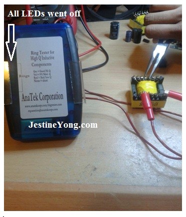

Then I made a short between pins in secondary winding with Long Nose Plier and there was no effect on LED bar of Blue Ring Tester. Please see the photo below:​
Note: A good transformer when shorted the secondary pins, the Blue Ring Tester LEDs should go off or one or two LEDs should be blinking. Please see the photo below:​
All the 8 LEDs went off when shorted the secondary pins with a long nose plier
A replacement with a new SMPT brought the dead power supply to life again.​

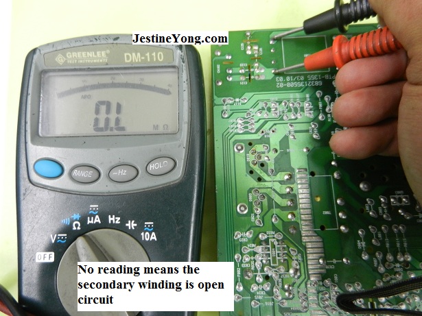

1) Open circuit especially the secondary winding

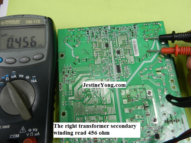

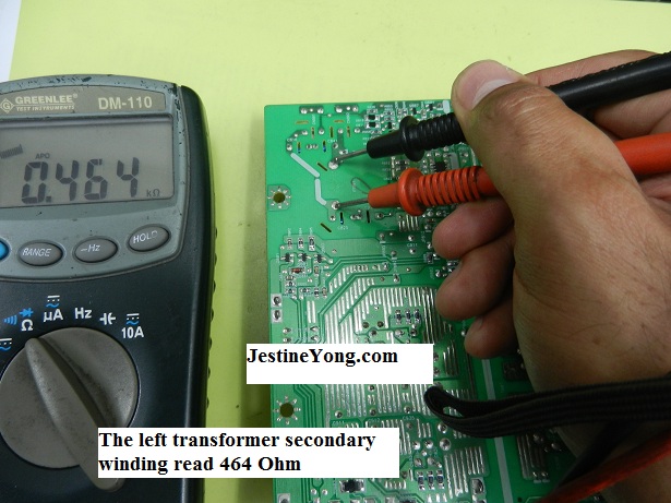

All secondary winding should have resistance between several hundred to several thousand Ohms. Just place your Ohmmeter at the secondary pins and you should get the Ohm reading. If you did not get any reading means the secondary winding already open circuit.​

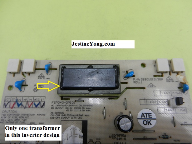

If there is a shorted secondary winding, a normal multimeter would not be able to detect it. You need to use a coil tester such as the Blue Ring Tester. For a much bigger high voltage transformer you can expect at least 4 LEDs will light up. If the tester did not light up at all means the secondary winding is shorted.​
Note: You also have to take note that a slighlty small high voltage transformer secondary winding may not be able to read by the Blue Ring Tester. The tester could read up until 2 or 3 LED lights only. However, if the LCD inverter has more than one high voltage transformer then it would be easy to judge the result (comparison test).​

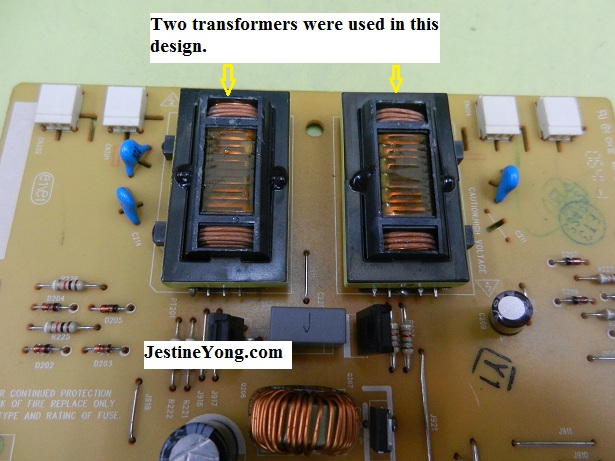

You can use the comparison method on the two transformers and locate the faulty one
Some designs only have one transformer but you still can compare the winding because the above transformer have one primary winding and two secondary windings

If you notice a vast different in Ohm’s reading (usually higher resistance) meaning to say the transformer is bad.
I have found many LCD high voltage transformers problem are due to increase in resistance in secondary winding in one of the transformers.​
Note: A slight different in resistance reading is acceptable when checking on two similar transformers.​
Most of the LCD inverter boards have more than one high voltage transformer thus it would be easy to compare the secondary winding and find out the problematic one.​

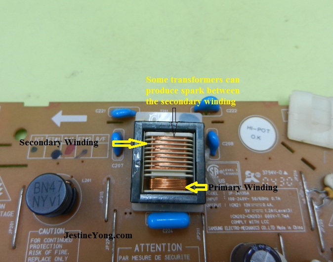

Although is rare, I did came across one before. On top of the secondary winding I saw a very tiny spark while the LCD Monitor inverter was working. It caused intermittent display shutdown. When I took out the transformer and test it, it seems to be working fine. A replacement brought the LCD Monitor back to life again.​
The question now, what if the transformer is fully covered and you can’t see the spark. In this case, it would be a little bit tough to solve it. What you can do is to make sure there is no bad components in the inverter circuit and all the CCFL lights are good (you can test them with a CCFL backlight tester). Check the transformer for good resistance reading and make sure no shorted reading (test it with a Blue Ring Tester). This means if you have checked all the parts and the LCD Monitor or the TV still have intermittent display shutdown problem then there is a possibility one of the high voltage transformers could be breaking down when under load.​
