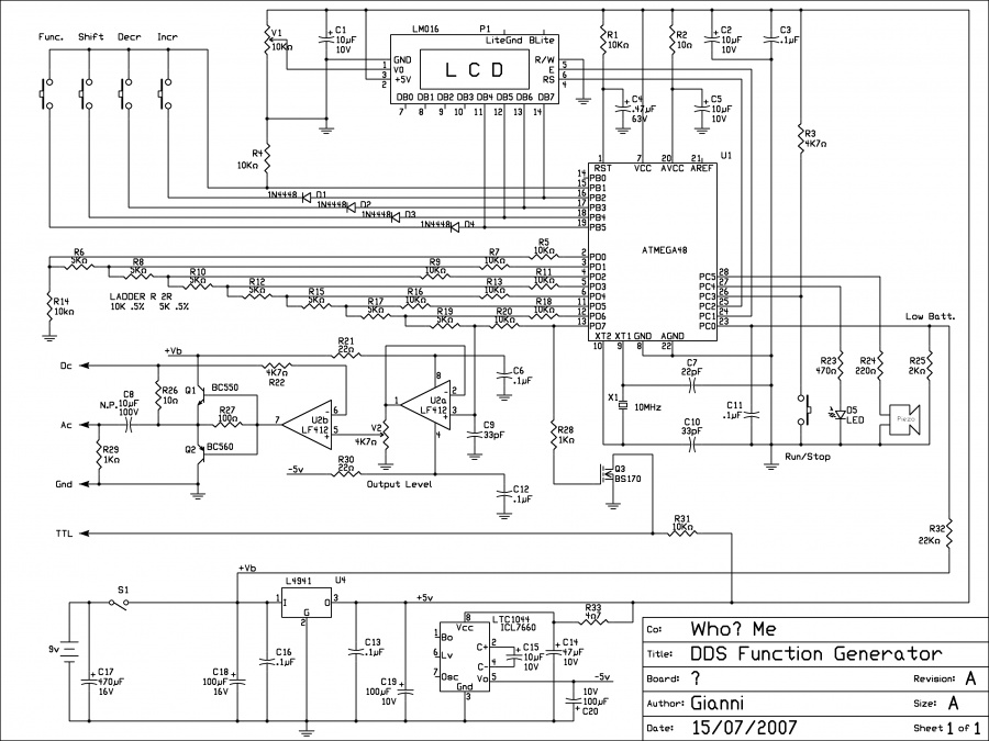

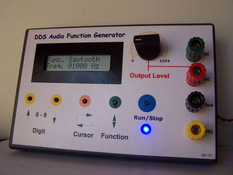

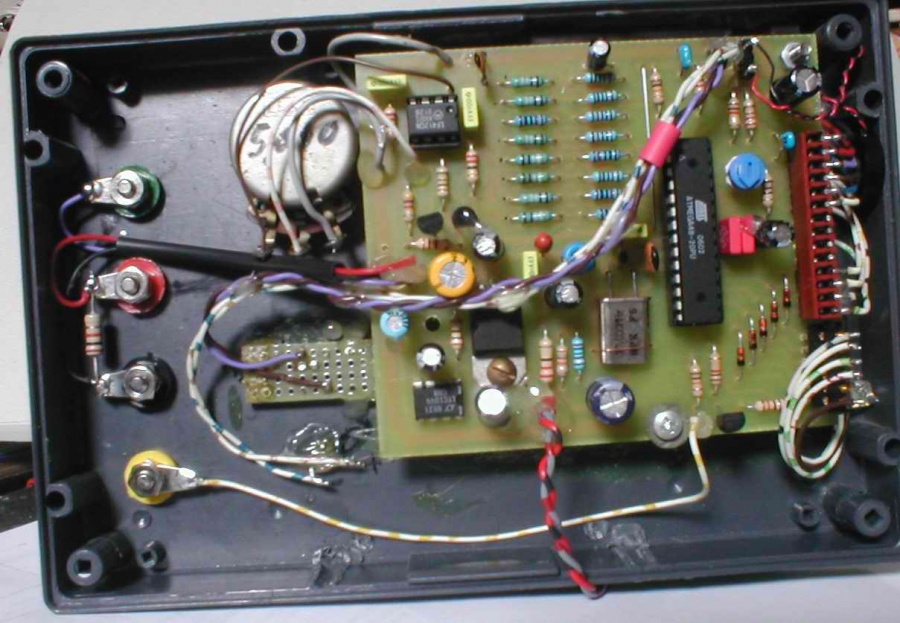

ژنراتور صوتی با avr
Frequency range : 1Hz - 20KHz useful to 100KHz
Resolution : 1Hz
Waveform : Sine, Square, Triangle, Sawtooth
Output level : Adjustable 0 - 5V.p.p.
Square wave open drain output (TTL compatible)
Battery powered
Resolution : 1Hz
Battery powered
