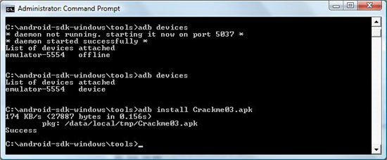

Now we need to install the software(crackme, its legal!) to the emulator. For that you may have to get acquainted with Android debug bridge(adb). Installing a apk file is pretty simple, all you have to do is to run two commands from Android SDK directory/tools.

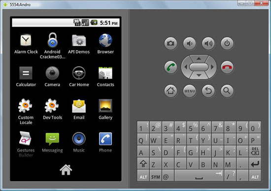

After the installation you can see the crackme icon from application menu.
Now run the crackme by clicking on it. If everything went as expected you will see the crackme application on the screen.
Now we will play with it, pressing check button with no inputs pops a message 'Min 4 chars', and with a proper name it pops up 'Bad boy'. We have to remember these strings because we will be using them as our search keys when we disassemble the apk(actually dex) files. Also note that we have two hardware ids and we need to find out what those exactly means.

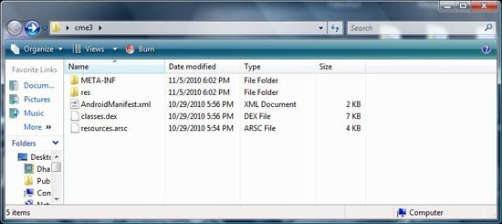

As our crackme is up and running in emulator, we now move onto reversing it. If you have read apk file format, you can visualize it as a extended JAR file which essentially is a zip file. Now you can change the crackme file name from Crackme03.apk to Crackme03.zip and decompress it to any folder.

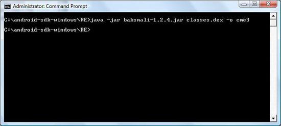

Now the interesting file for us is classes.dex, which contains the compiled vm codes. We are going to disassemble the dex file with baksmali. Commands are pretty simple as you can see from screen shots.

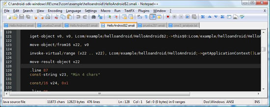

If everything worked fine, we will have a folder structure similar to Java packages. Interesting .smali files are located at '\com\example\helloandroid'. Open all the .smali files into your favorite text editor(I use Notepad++). If you have never done anything related to reverse engineering/esoteric programming/assembly(IL) programming, you will probably think: WTF!. Relax. We have just opened a disassembled dex file. Now, if you are thinking how on earth someone can find the correct location of checking function, I hope you remember those pop up strings I told earlier. Yeah, 'Min 4 chars' and 'Bad boy'. Now we will use those strings as our search keys. Searching �Min 4 chars� in all the opened .smali files, we will find a hit in HelloAndroid$2.smali line 130.
Our aim is to understand the serial checking function and write a keygen for it. For that we have to know all the dalvik opcodes that are used here. You can visit this page to understand the opcodes and after that you can convert disassembled code to much higher language constructs. I will provide a brief code snippet which actually implements the algorithm. Two hardware ids used are IMEI and sim serial number.

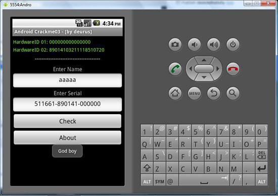

Now we will put the same magic number into our Crackme application.
Bingo! everything worked as expected. Now, for all those who thinks it is pretty hard to read all those disassembled instructions and manually converting them to higher language constructs, there are other options. As dalvik is based on design of Java, it is also susceptible to decompilation. There is no decompiler available at this moment, but there is hope.
