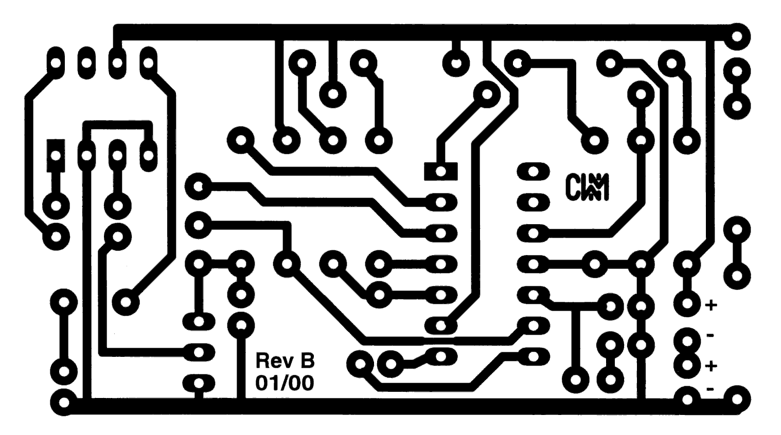

Figure 1 shows the 8038 signal generator circuit. This is a very standard configuration given in the Intersil data sheet. The output frequency is set by R1 and C1 (plus C2) to be approximately f=0.15/(R1*C1). The sine wave output at pin 2 is then fed through an R-C low-pass filter (R4-C3) to the LM386 audio amplifier. Figure 2 shows the PC board for this circuit. Note that the PC board includes some extra pads for optional circuitry that is not used in this project.
Fig. 2: Transmitter PC Board
[SIZE=-1]Click on image for 300dpi resolution (scanned at 2x)[/SIZE]
Since this MFD is only designed for gold and silver there are only two frequency selections and therefore the 8038 only needs two capacitors. One capacitor (C1) is always connected to the 8038 and results in a frequency of 8.7KHz. S2 switches in a second parallel capacitor (C2) that decreases the frequency to 5KHz. The low-pass filter (R4-C3) has a cut-off frequency of around 10KHz and helps suppress the output harmonics of the 8038 for better spectral purity. Finally, the LM386 provides gain and drive capability for the ground probes.

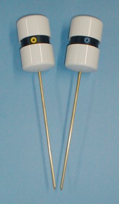

Once we have the circuitry working what do we do with it? We will do what every other MFD manufacturer does: connect the output leads to probes that are stuck in the ground. Each probe consists of: a short (6") piece of 2" PVC pipe, two 2" end caps, a 12" length of 3/16" brass rod, a banana jack, a wire clamp, and some wire. Figure 4 shows the material needed to make two probes.
Fig. 4: Probe Parts
First, use a high-quality drill bit and drill a 3/16" hole through the center of one of the end caps and just slightly into (but not through) the inside roof of the other end cap (see Figure 5). The brass rod should slide through the hole with a considerably tight fit which is why you want to use a high-quality drill bit. Cheap bits tend to have inaccurate sizes. Drill a hole in the side of the 6" long pipe to accept the banana jack and solder the wire to the jack. Assemble everything but the top end cap. You may want to clean and paint the short pipe section for a sharp appearance.
Fig. 5: Upper cap
Fig. 6: Assembly
Fig. 7: Final Probes
With the rod pushed through the assembly by a couple of inches use the clamp to attach the wire to the rod (Figure 6). Finally, add the top end cap making sure the rod goes into the half-hole in the inside roof, then push everything together. You may want to add PVC cement to the end caps and some epoxy where the brass rod goes into or through the end caps to hold everthing together securely. Sharpen the tips of the probe rods (to about 45-60 degrees) to make it easier to push them into the ground.
In Figure 6 you may have noticed that the connecting wire from the banana jack to the rod is spiraled around the rod. This technique generates a molecular polarization field that is directly induced into the probe rod and eliminates all false (ghost) signals. The spirals should be wound in opposite directions for each probe. Once the probes are finished you will need to make a pair of banana wires to connect the MFD transmitter to the probes. The finished probes are shown in Figure 7.

خروجی های signal out هر کدام به یک میله برنجی نمره 3.5 به طول حدود 15سانتی متری و صل میشوند و با فاصله 20سانت از هم درون زمین فرو میروند(میله های در شکل زیر دیده می شود:

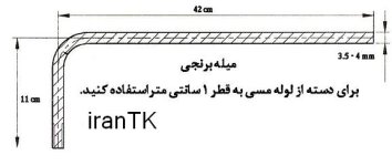

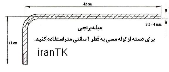

جنس میله برنج 3میل و برای دسته هم از لوله مسی به قطر 1تا 2سانت استفاده شود طوری که میله برنجی به لوله دسته وصل نباشد , می توانید برای اینکار از 2عدد واشر آب در بالا و پایین دسته استفاده کنید و میله را درون دسته قرار دهید طوری که میله آزادانه بتواند حرکت کند.
آنتن ها هم به شکل زیر ساخته می شوند:
