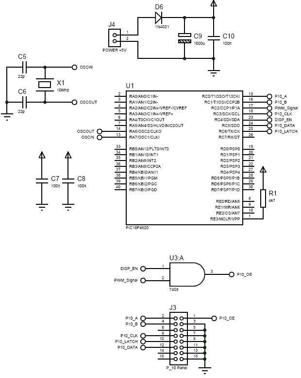

Here I used 18F4620. I ran at 40Mhz with 4xPLL. Also sending data using hardware spi module max. I tried to reach top speed. Oladukça of spi spi hardware and software have much of a speed difference.
Pic of the connections between the panel gave the following as the schema.
Panel on driving in the first place obviously had no idea when I received. Once you know how it works for the screen by myself, take a ram in the ram region with the Timer Interrupt constantly mirrored on the screen. I used two-dimensional array for the job.

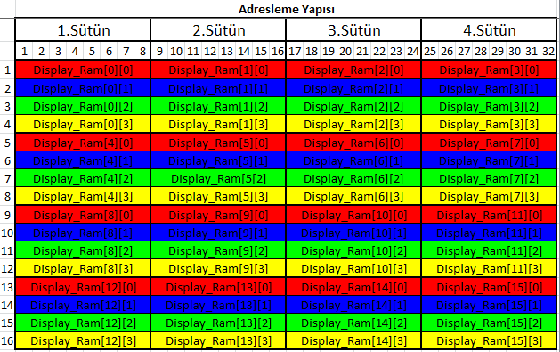

The structure of the display RAM can be found below.
Timer interrupt this ram used to reflect the screen area. After setting the timer interrupt to occur 800uS a region of interest of each of the named directory screen displaya_ram send interrupt occurs, the information is displayed when the active line. This process must continue constantly.
